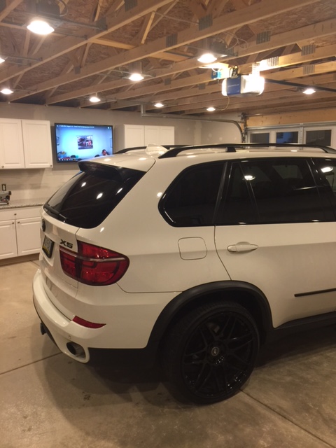

HOW do you keep your garage and countertop so.... empty?!
Haha its only 3 months old... Slowwwwly finishing it... Thats 13 feet of Granite Countertops in the back!
