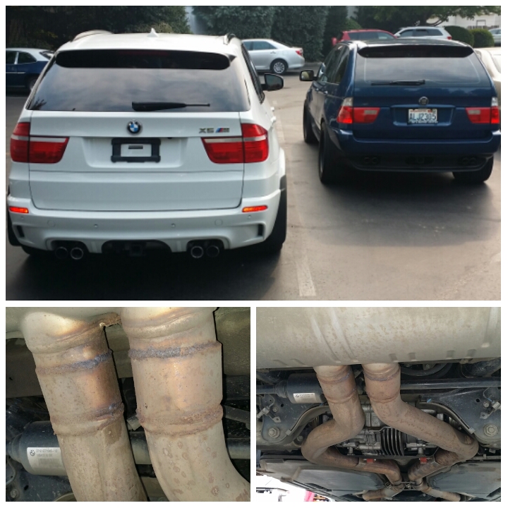

I got this problem RIGHT after I got my exhaust done, like pulling out of the shops parking lot. That's the only reason I started my diagnosis there. Looked under the vehicle and noticed that the two rubber hoses for the valves from the stock muffler were just hanging. After plugging them up the problem was gone.
Granted, mine was flashing the warning on somewhat harder acceleration runs (by no means WOT). I also noticed that it would reduce the power but would not go into limp mode, per se. Warning would be gone upon restart, like yours.
If you have an aftermarket muffler, that's where I'd check next.

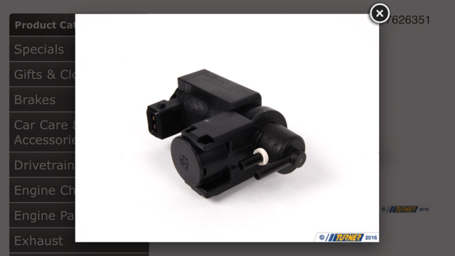

Explanation above but This is what the part looks like the two tubes plug into it, check for crakes in the tubes

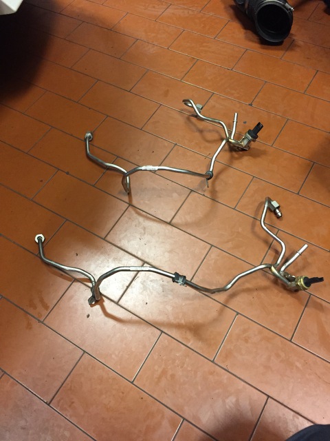

Diagram showing part "11747626351" and all the hosing that goes with it
It is #2 pictured
There is quite a bit of vacuum hosing here will investigate this most likely replace the hosing.
It is #2 pictured
Yep that's the little bugger, just check the hoses that connect to the unit and follow it to where it ends or just replace the hoses as their cheap and it's getting to the age where they are starting to dry out. Think of it as preventative maintenance.

I left you a couple of pictures of where the lines are in correlation to the muffler in the other thread. Bottom of first page.
http://www.xbimmers.com/forums/showthread.php?t=1222381
If you get underneath the vehicle and don't see the lines by the bumper then they may have been removed by the shop that installed your muffler.
Not sure if that's the solution to your problem, but...

I'm at the BMW 100th Centennial right now, but I'll update more soon. Intake sounds awesome....whoooshhhhh, doo doo doo doo :-)

I'll be installing this tomorrow, so I'll look closer then. In the meantime, anyone know what size vacuum line we need because I'd rather just replace it all at this point.
Link for the grilles? Interested in picking up a set.

The picture with the grills and CF hood aren't mine, but they're just F15 X5M grills you can find on eBay or wherever.
