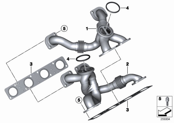

Looks very similar to the F10 M5 exhaust manifold (attached).
It makes me wonder how much power can be yielded with an F10 M5 exhaust manifold and turbo's vs. aftermarket exhaust manifold and modified turbos. From a cost standpoint aftermarket will still probably be the better solution.

F10 M5 exhaust manifold part numbers:
11627843780 (cly 1,4,6,7) 949.21EUR ($1267USD)
11627843781 (cly 2,3,5,8) 949.21EUR ($1267USD)
Total Cost $2,534USD (1898.42EUR) + fee's, customs, taxes, shipping. Expect to pay around $3,000 after everything is said and done.
(I've seen some places want as much as $3346 just for the pair of manifolds)
You'll also need two gaskets (goes between the clyinder head and the manifold). Costs $71.84 for the pair (part # is 11627589106)
You'll also need two gaskets (goes between the manifold and the turbo's). Costs $21 for the pair (part # is 11657845076)
I also suggest replacing the gaskets for the connection between the turbo and downpipes, and the bolts for the exhaust manifold depending on the age/condition.
In terms of time, expect to spend 4-5hrs to do the exhaust manifold (just doing the downpipes takes a minimum of 3hrs). You'll also need basic tools, though you'll need an assortment of torx (or 8pt sockets) and hex sockets for a majority of the bolts. Its also a great time to either swap the turbo's and/or downpipes given you'll spend a minimum of 3-4hrs doing either modification in the future.
Have fun and enjoy the power. The spool up and top-end should feel improved, though won't be as dramatic unless you remove the catalysts and retune the maps.
If you want to modify the stock turbo's I suggest contacting Precision Turbo and they can offer a quote for custom (enlarged) billet compressor wheels and enlarged turbine housings or better flowing turbine wheels. It all depends if you want more top end power, mid-range power, or low-end power. I'd suggest going with a 2-4mm increase in the compressor wheel and increasing the a/r on the turbine housing by .20 for a decent improvement without going too wild. The cost should be reasonable, around $2-4k depending on what you ask for. The only limitation is you will need to either modify your factory turbo's or buy new versions to modify which will add an extra ~$4,800 to the bill.

Guys I just ordered AA catless downpipes and software which . Are you guys saying if I install the headers from the new M5, i will have an additional increase in HP? Guys please clarify and how much HP will this M5 header add and is it a direct swap without any modifications? Please tell me as I am in NYC now so I can order them before I go back to ghana in 2weeks. thanks
      04-15-2014, 10:28 PM   #22
CrazyRC
25
104
Drives: X3M40I
Join Date: Apr 2014
Location: Airdrie
From what I've been told its not a direct swap. It will bolt to the motor but needs some custom fab-work to fit the turbo's.
