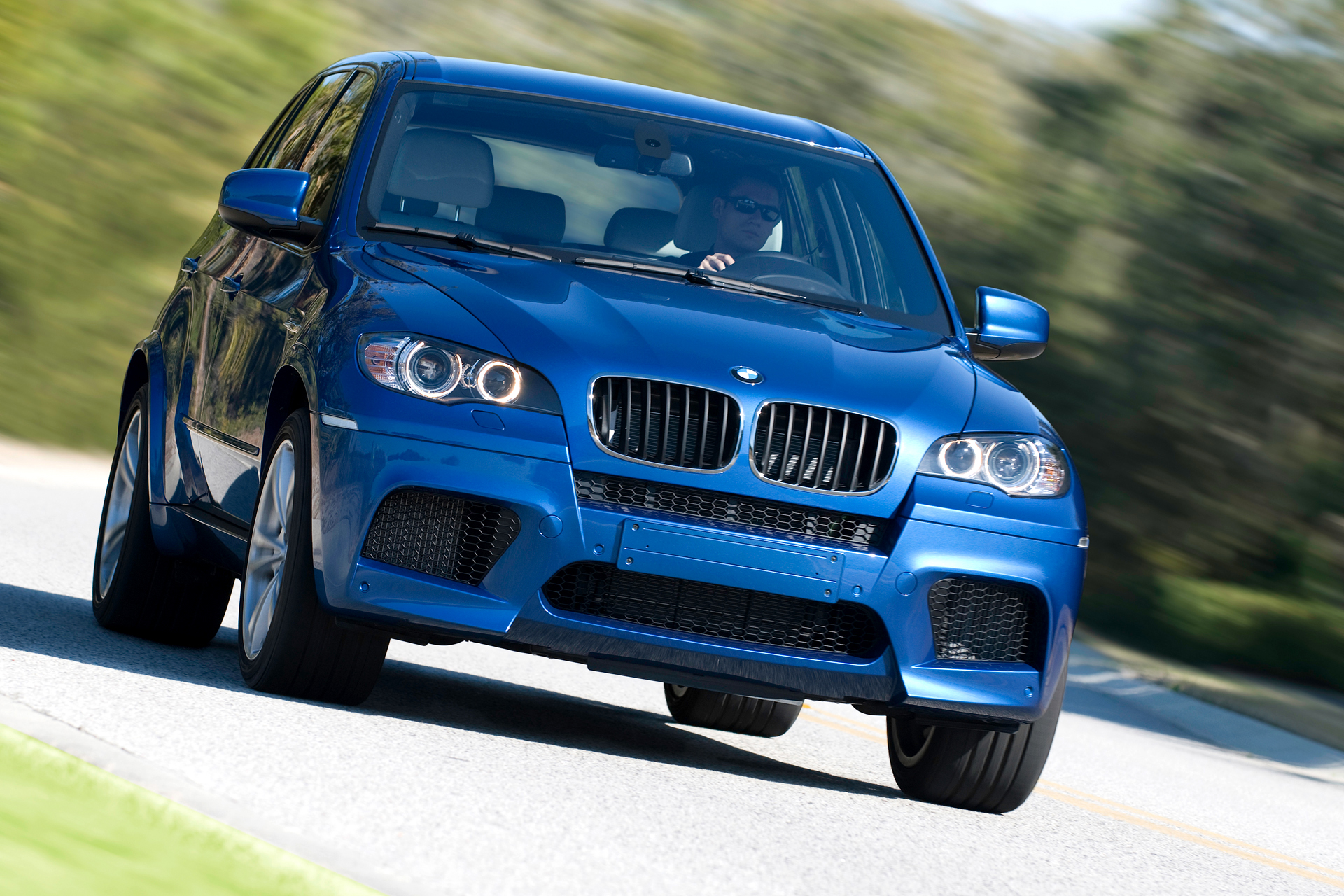

BMW X6M and X5M
Size:  156.0 KBName:  x56m-2.jpg
Size:  99.2 KBName:  x56m-3.jpg

X5 M: proportions signal presence and versatility.
Though the two models’ frontal aspects are largely shared, the X5 M is notably recognizable by its more upright and taller overall height. (Its windshield is taller and not as raked.) In profile, the X5 M is of course “squarer,” and of the two only the X5 M has optional roof rails; these are in high-gloss Shadowline finish.

BMW X5M Wallpapers
BMW X6M Wallpapers
BMW X5M Monte Carlo Blue
