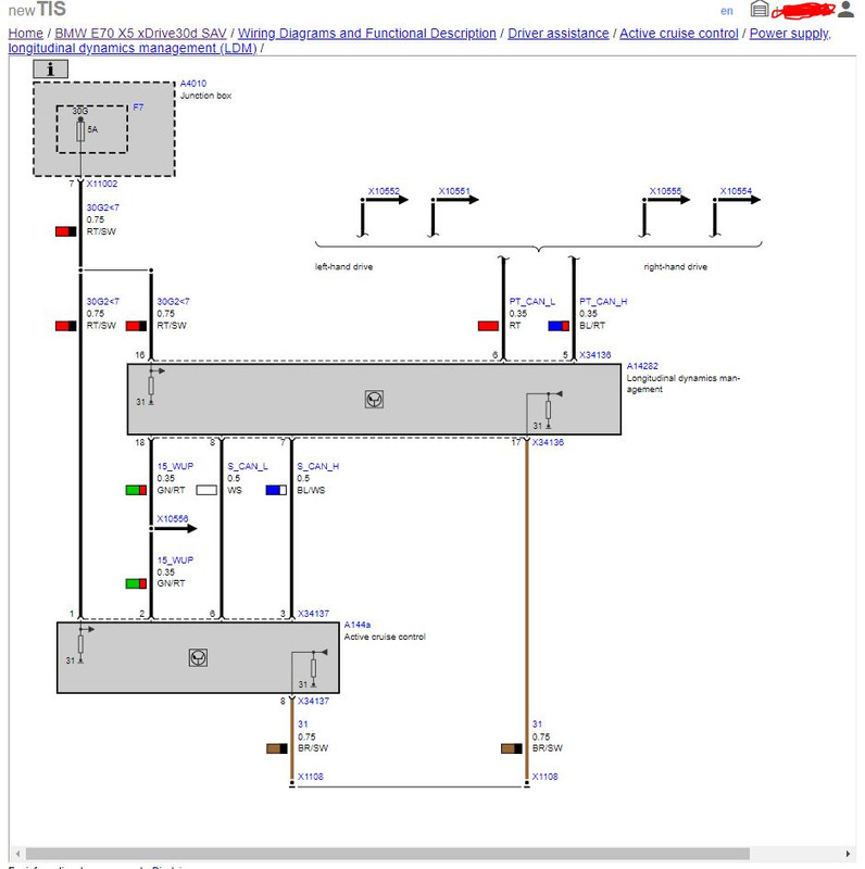

I am freaking out right now, because all of the pieces are enroute to me next week, and Newtis is shut down!!! Just plunked down and pulled the trigger last week. Can you help me with the wiring plug numbers and colors between the ACC, LDM, and DSC units? I did not anticipate the shutdown, and didn't take any pictures of the schematics! I really hope I can wire this up blind with all your help without NewTis!
I remember that P_CAN is R and R/BU, but what pins are the S_CAN? Also couldn't remember the wire color and location for the wake pin.
Fuse is F7 I believe, which piggy backs onto the RDC fuse.
Where does the LDM mount? I remember seeing a picture at the driver side.
Thanks!!

Shoot!
That's no bueno..
They say in their blurb about BMW AG to email them with any questions. Ask them where you can get the info? lol
