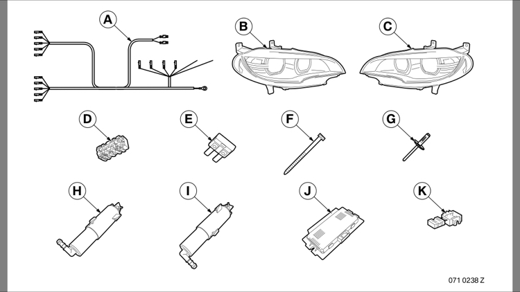

Hey brother did u had to get this connectors to Finnish ur headlights retrofit ?
( D , E , K ) thanks
Hey, these connectors were all together in the same package with wiring harness. I did not have to get them separately, but they are required. You can also purchase them just about from any electronics store or maybe even home depot.

Below are the coding instructions. Nothing too complicated:
LED Lights: I just modified my VO String in NCS Expert to add option $552 and delete $522, $524 to my CAS and FRM module
Change production date to #0412
Remove $522 and $524 (AHL if you have) and add $552 to CAS & FRM and code car.
If you are not comfortable coding the whole car then just code CAS, KOMBI and FRM with expert profile.
REMOVE:
$522 - FRM//Xenon light
$524 - FRM//Adaptive Headlights
ADD:
$552 – FRM//Adaptive LED headlights with Anti-Glare High-Beam Assist, incl. variable light distribution and cornering lights
Installing new FRM module:
coding FRM module step by step:
A:
1.open NCS expert
2.File-Load profile
3.select EXPERMODE
4.press F1
5.press F3
6.select E70<for E71>
7.press BACK
8.press F3<CHOOSE ECU>
9.select NFRM
10.select FA_WRITE from CHANGE JOB
11.press F3<EXECUTE JOB>
B:
1.open NCS expert
2.File-Load profile
3.select EXPERMODE
4.press F1
5.press F3
7.press BACK
9.select NFRM
10.select SG_CODIEREN from CHANGE JOB
