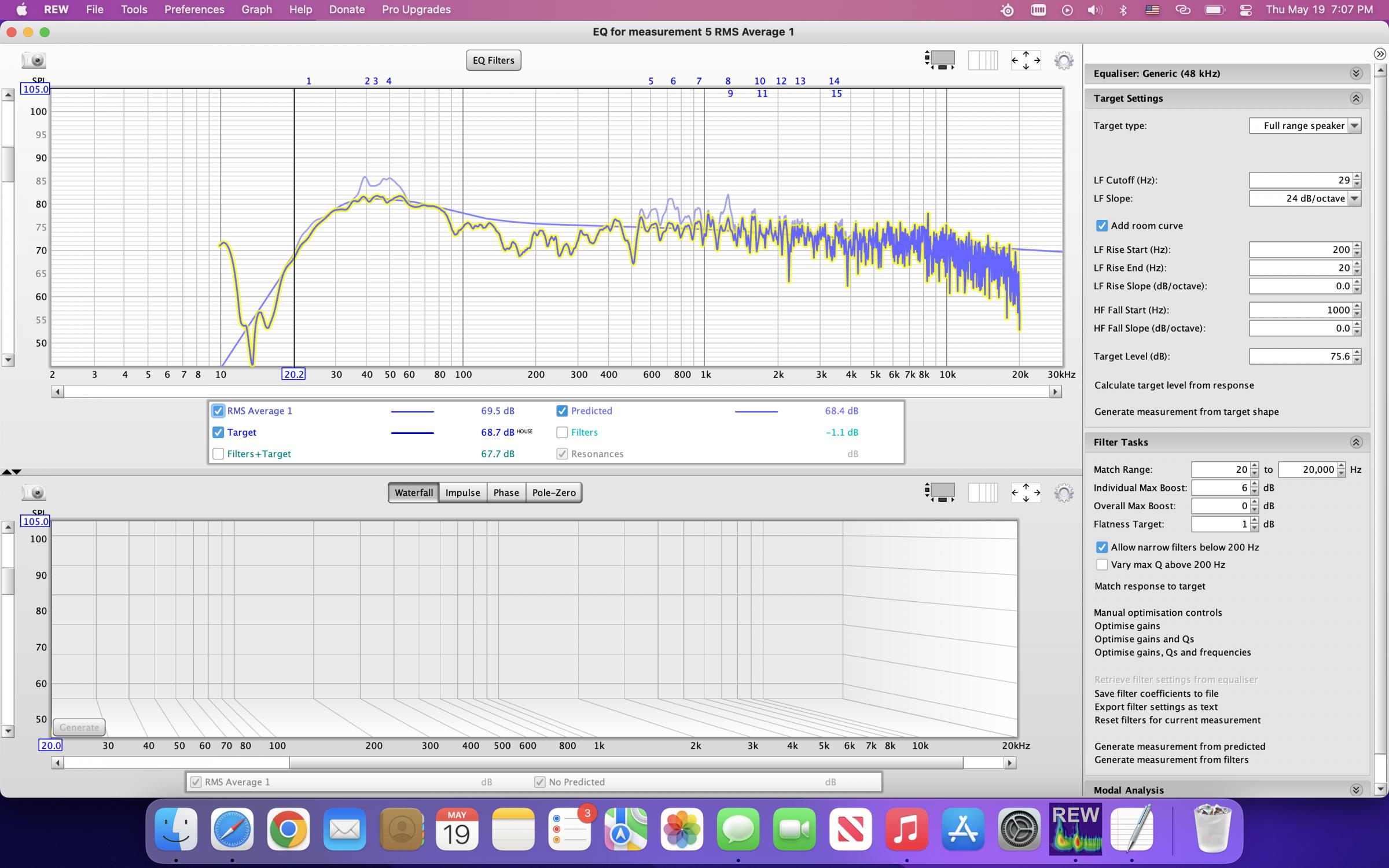

Above, the original sampled frequency response (average) curve. I took three slightly varying measurements from each location at ear height. The locations being: drivers seat, front passenger, front center console, and rear left-center-right seats. As you can see, there are basically two lines. The higher curves are from the front, and the lower curves at around 50hz is from the rear seats. I think this has to do with the balance/fader settings (which I did not touch). I just averaged the two in my settings.

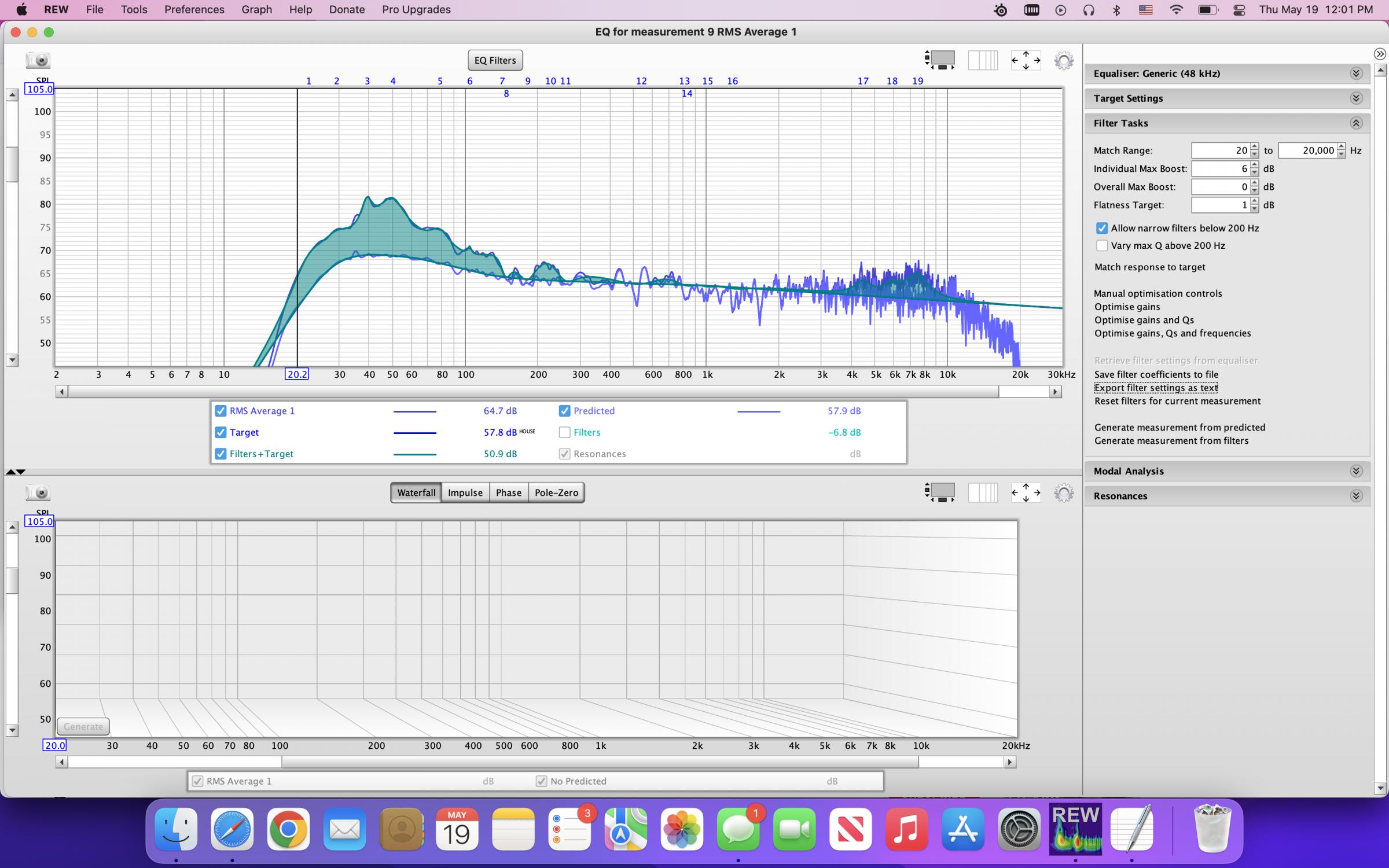

Name:  Screen Shot 2022-05-19 at 12.01.50 PM.jpg
You can see that for the original frequency response curve, REW suggests reducing the heavy, heavy bass in the factory tuning, and the higher frequencies. We can conclude from this original graph that we need to reduce the bass either in the EQ or in the treble/bass settings, and mildly reduce the higher frequencies.

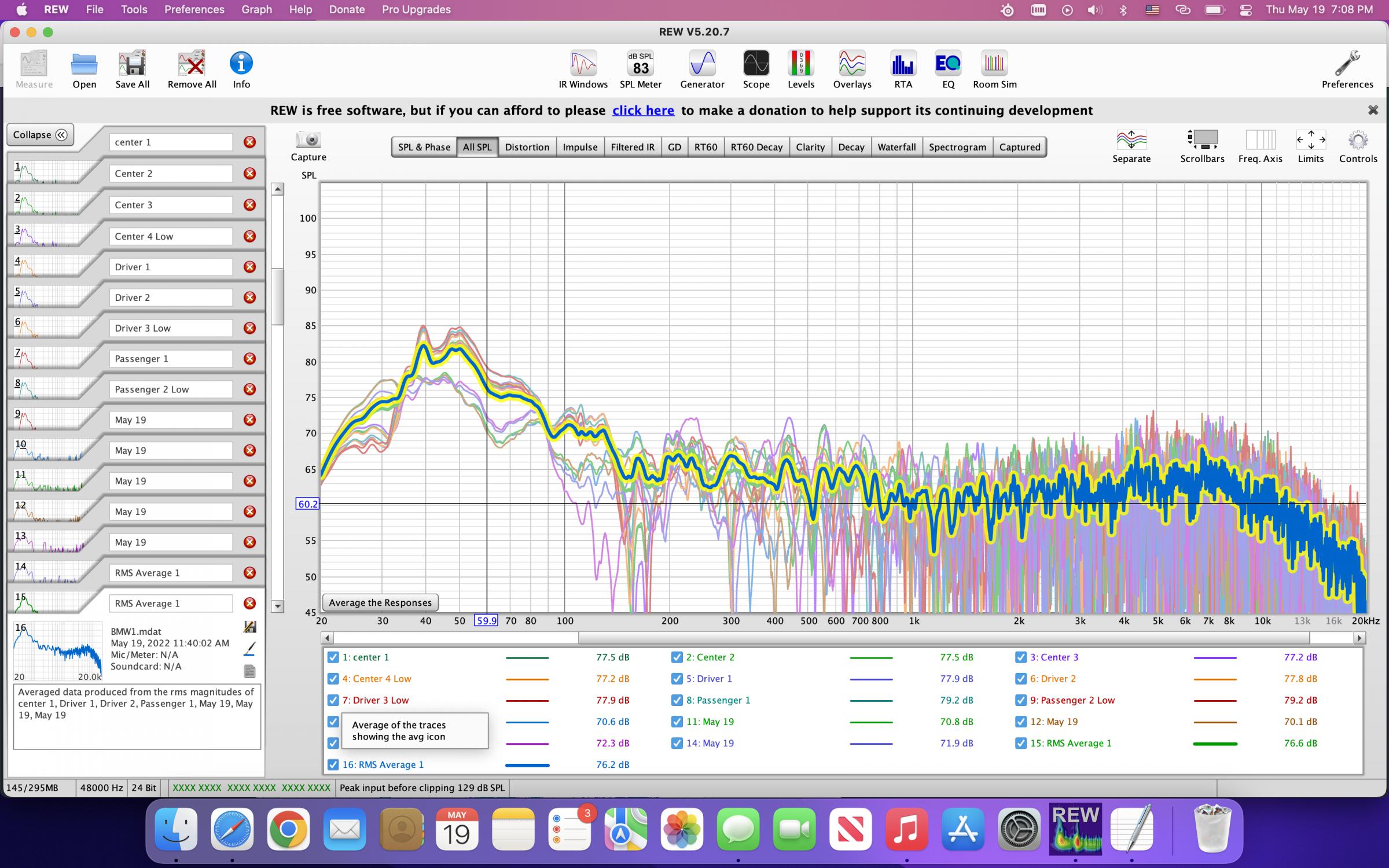

Name:  Screen Shot 2022-05-19 at 7.07.29 PM.jpg
Above is the 8th iteration of the frequency curve with treble, bass, and the equalizer edited. I think this is the closest I can get the frequency response to be a clone of the Harman House Curve. Setting the settings to my settings, the sound is very balanced. If some extra lower down bass is required, you can set the 100hz to -1.
If you look at the final frequency response curve, you can see that there is a peak at 40-50hz. This seems to be a characteristic that cannot be rid of. Maybe this is due to limitations of the 'room'.

Depending on the genre of music you listen to there is likely a lot of musical bass energy in that range. No matter how I tune with pink noise there will always be peaks, it’s just how the music was recorded. Also could be the underseat location or just the interior, although my underseats have been cut off at 80hz for awhile now. My sub in the trunk is from 20hz-70hz. Sound deadening might be worth looking into also. I’ve done a lot of it and I still need to do quite a bit more, but it helps a lot with unwanted lowend frequency energy.

FYI cabin gain starts at about 56hz in our x5s, which is most likely the reason for the peak in the bass. Then it drops off by about 40hz because the underseats lose their oomph by then.
