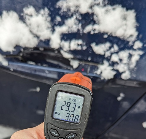

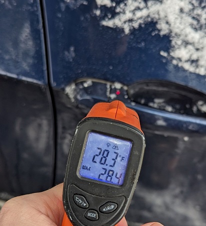

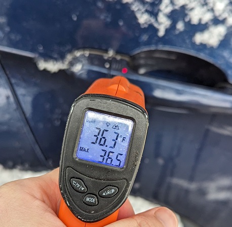

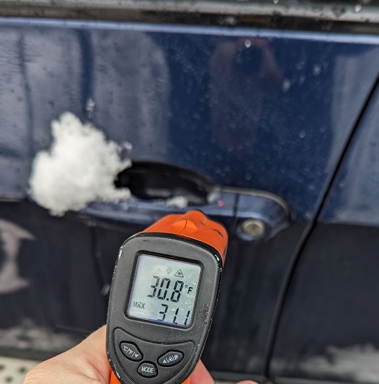

Got the yellow battery light in the dash while starting this morning and the glow plugs were doing their thing in the cold weather. Ended up taking a bit of a shortcut by using a $15 infrared thermometer that I had on hand.
It is possible the sun may have warmed the one door handle more than the others, but I feel like the snow would have melted nearby if so. Plus the same handle that was warmer than the others also acts a little funky in wet weather so I'm almost positive its the problem one. Disconnected it to hopefully confirm its the issue.
