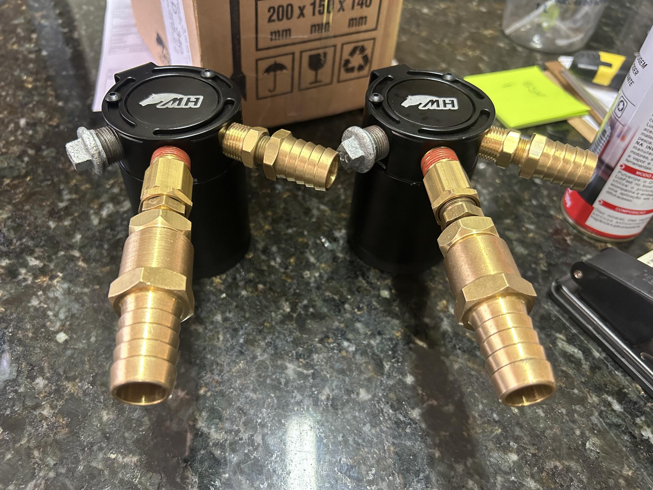

Greetings everyone, first of all, this text is being generated by the GPT chat, so occasional spelling errors may occur, and I apologize for that.
Here we go, I'm setting up a system in my car, an S63. I'm going to install the junction between the valve cover outlet and the 3-way component, while also maintaining the connection between the benches.
My system will have only 1 input and 1 output. I'm using the vacuum control valve recommended by Sophisticated Redneck, and I've added this series of adapters to see how I will assemble the final piece.
In my case, it's a 3/4 inch outlet or 12AN.
I've attached photos of the adapters. Basically, it looks a bit messy, but I'm going to create a single CNC-machined piece to achieve a cleaner and more functional look.

Not sure why you are doing all this; Troy has about 100 hours in designing and building a system that will look 1000x better, and cost a fraction of what the time to buy all those brass parts. the two port setup will have its issues, if you go through why this is, look and read the entire thread, it covers why without all 3 ports, you will have issues or CELs.
I guess if you want to make your own version, that's cool, but we literally did this to help the community out, not to get rich on, our pictures are better than anything out there, and to eliminate needing to use plastic OEM parts that will crack and break over time.

Simplifying and showcasing all my Paint skills I'm going to place the reservoir with this connection.

Certainly, the connector you've made seems to be very well-designed and solves the issue of plastic connectors' fragility once and for all. My question is regarding the need for two reservoir inputs.
As far as I've observed, the system releases vapor through the valve cover and suctions through the intake, before the turbines, and later through the intake manifold.
Please send me a private message as I don't have this function enabled yet due to my low number of posts.
I'm using this video as a guide for locating and connecting the system.

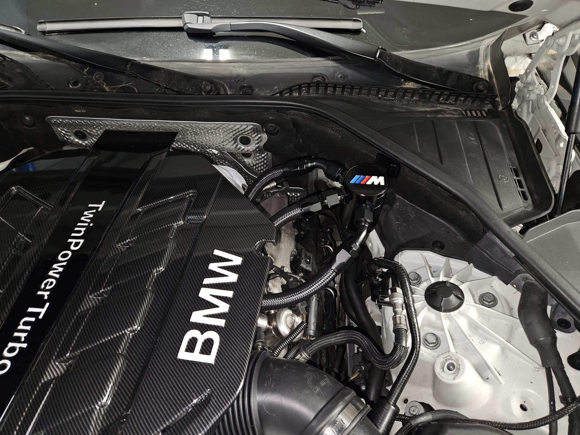

Here is the drivers side CCV, not finished, going to shorten the back port with a 90 degree so its a shorter run to the valve. Troy is a master as you can see of this M7 motor. ha

Small improvements to the driver's side, better angles and hoses are shorter.
AS you can see, the leanest, nicest CCV setup ever; even the valve is hidden on the bottom side unlike other setups.
Those interested PM me, i got pricing from Troy to make them, not bad at all.

Pics of the full install attached on my M7 N/S63 Kit come with everything: hoses, vacuum valve, connections, etc.
Kit also comes with a pre-set vacuum valve (it's hidden down below at the engine case connection, unlike those that put the ugly brass valve at the top.
Those interested, PM me; if you cannot PM, post here, and I'll PM you. Only doing this to help Troy, so he can recoup some of his hard costs; he is offering this at a great price, and certainly well worth the money.
He's going to expand to all new current model cars now too.
Thanks

This is a F02 750 that i made into a M7, with a N63 and many cool things.
Adding more pics so you can see all the connections.
I am not a sales rep, i helped on the building of these functions.
I cant speak for Troy and DYI, but his parts are low cost that you'd likely spend more doing a DIY then use his kit, or a close even. Im sure he will help anyone that wants the ugly setup if that is their goal, I'm sure he wont care.
Im sure he can sell certain pieces, but that's his call, he's still busy machining and looking to make it cool.
He made a custom pressure valve (not annodied in this pic, but it will be) so we didnt have to use the ugly big brass one off the catchcan. We also made connections that make this clean and right, as you can see from the final install pics.
I would give him a week or two on all of this, he's still putting things back together and sourcing more aluminum for the additional kits, but I'm sure he will take things on a case-by-case basis for those that want things.
Just give us a week or so, so he can get more pics of each connection, when in final version form, a lot of these have scratches from all the removals and take offs, to get the lines and connections right.
As for intakes, yes, I know he is aiming to get that going too, he just mastered the 3D CNC mill, so that is what took the time to get these made right.
