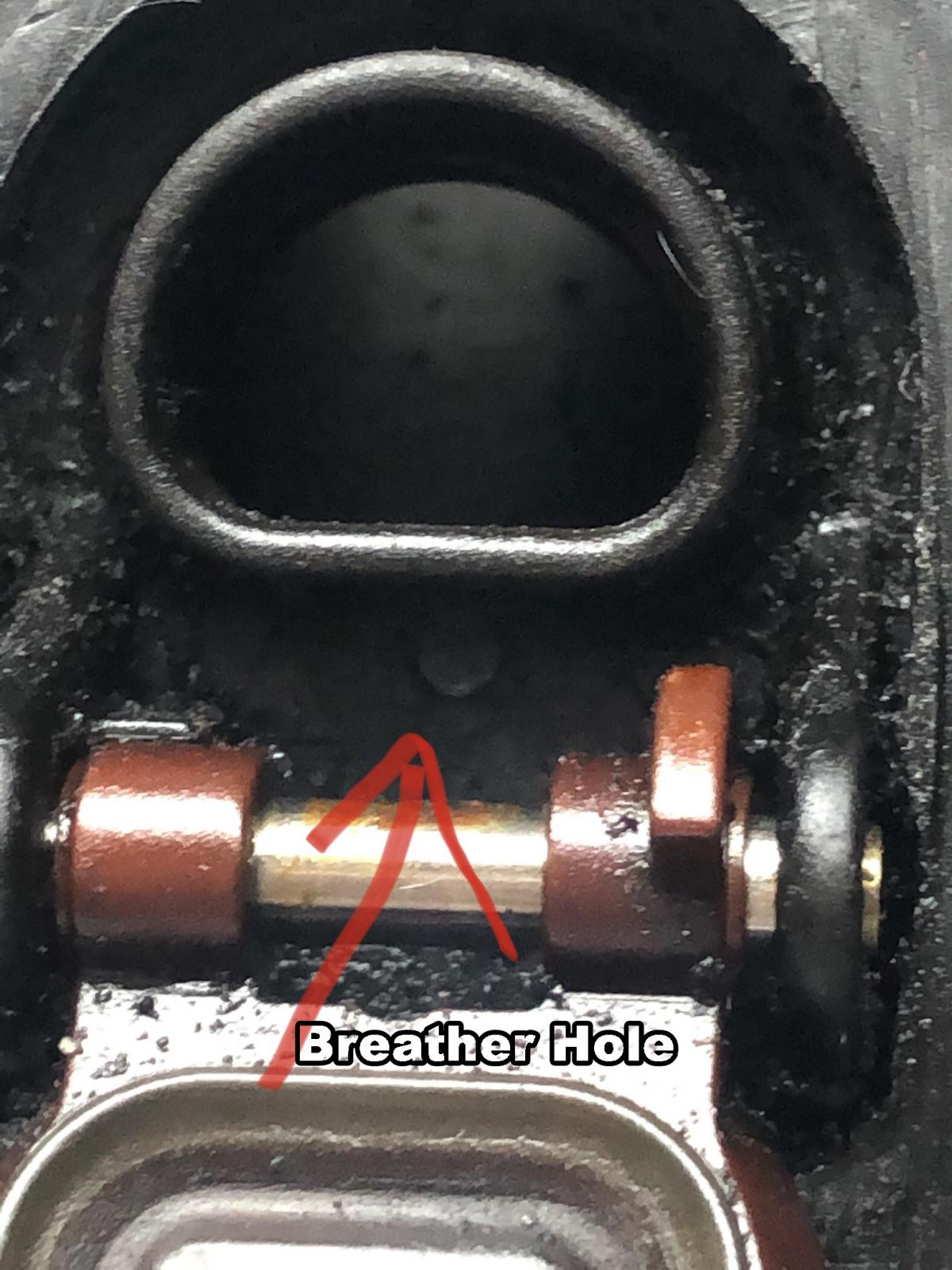

N63 warning
Just wanted everyone to be aware that the aftermarket replacement parts are defective. The original part has a breather hole next to the one way flapper. This breather hole is missing on the aftermarket parts sold everywhere. Please see image of the original part I uploaded here....
