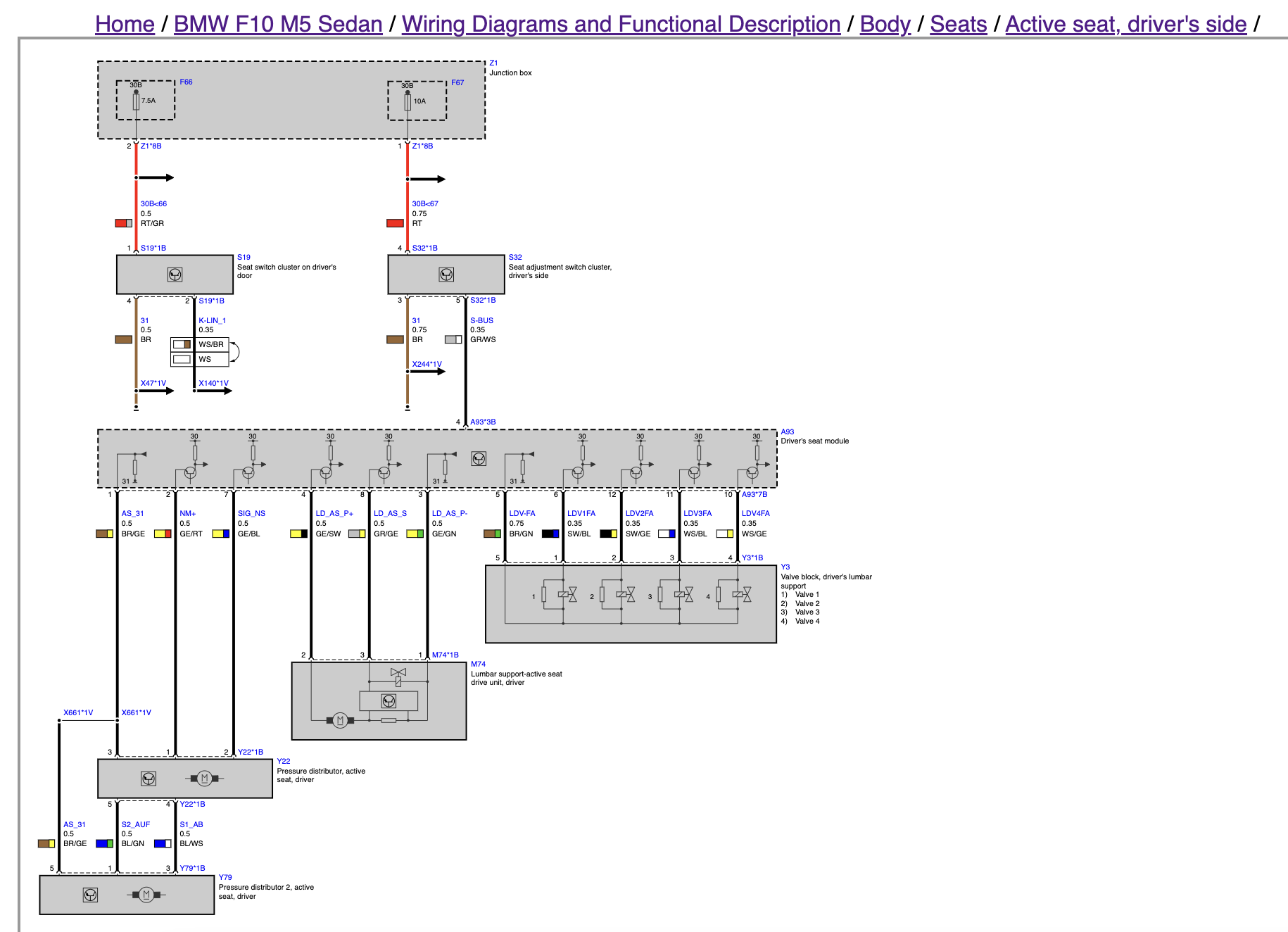

Ok - that had some resolution that was better than my laptop that has ISTA-D. I see from another thread and the pics above, that it looks like the yellow connector contains X275, and maybe X276 and X279? Many of those modules use the Green, Green/Orange K1 feed.

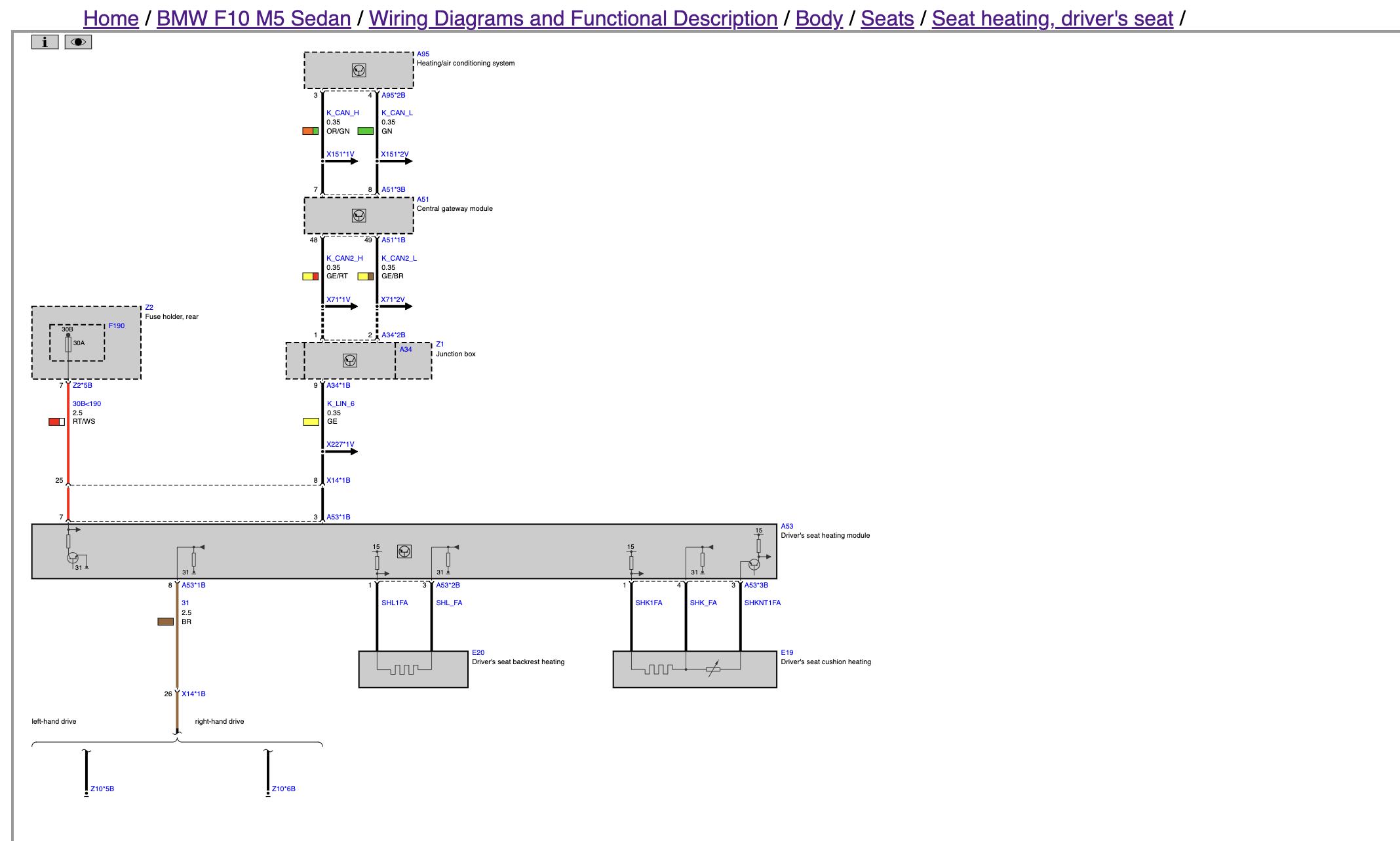

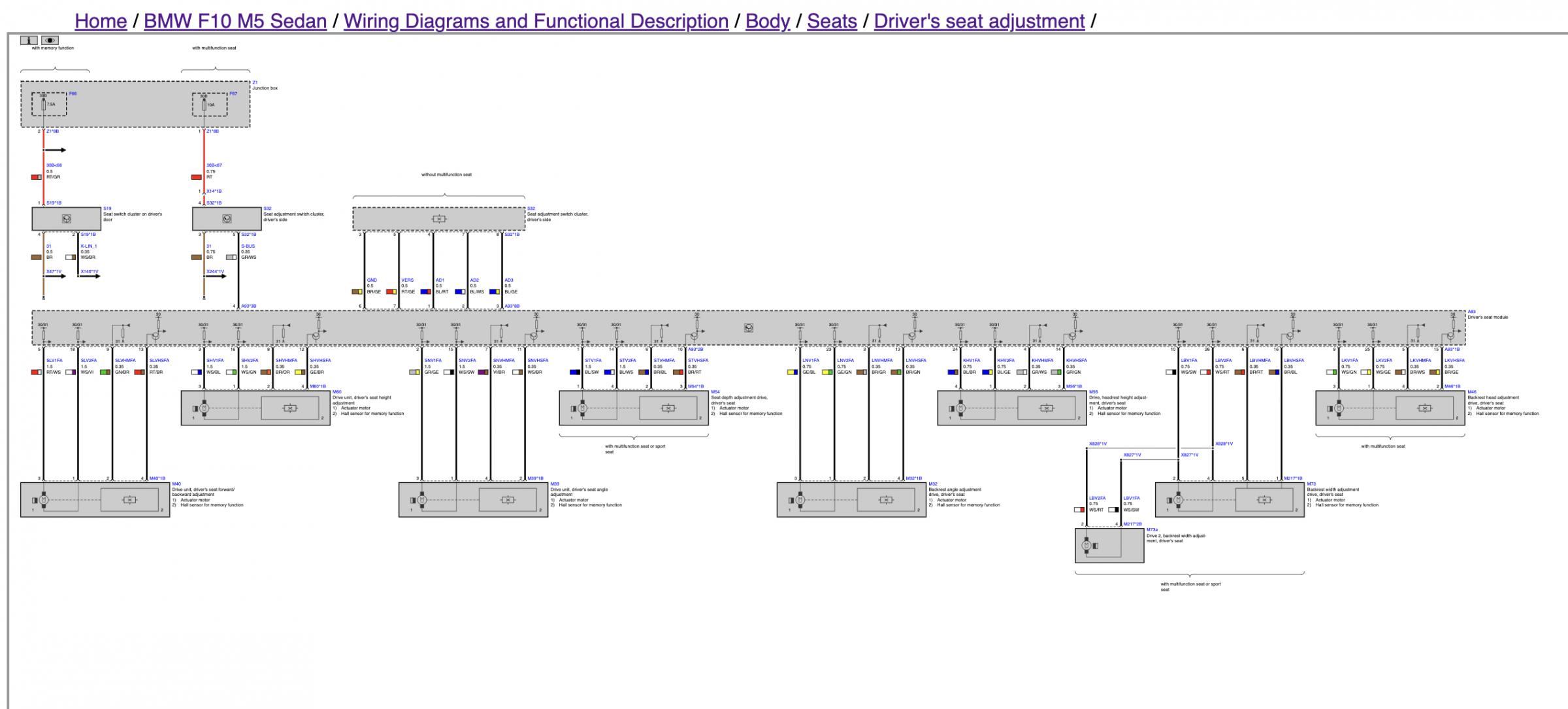

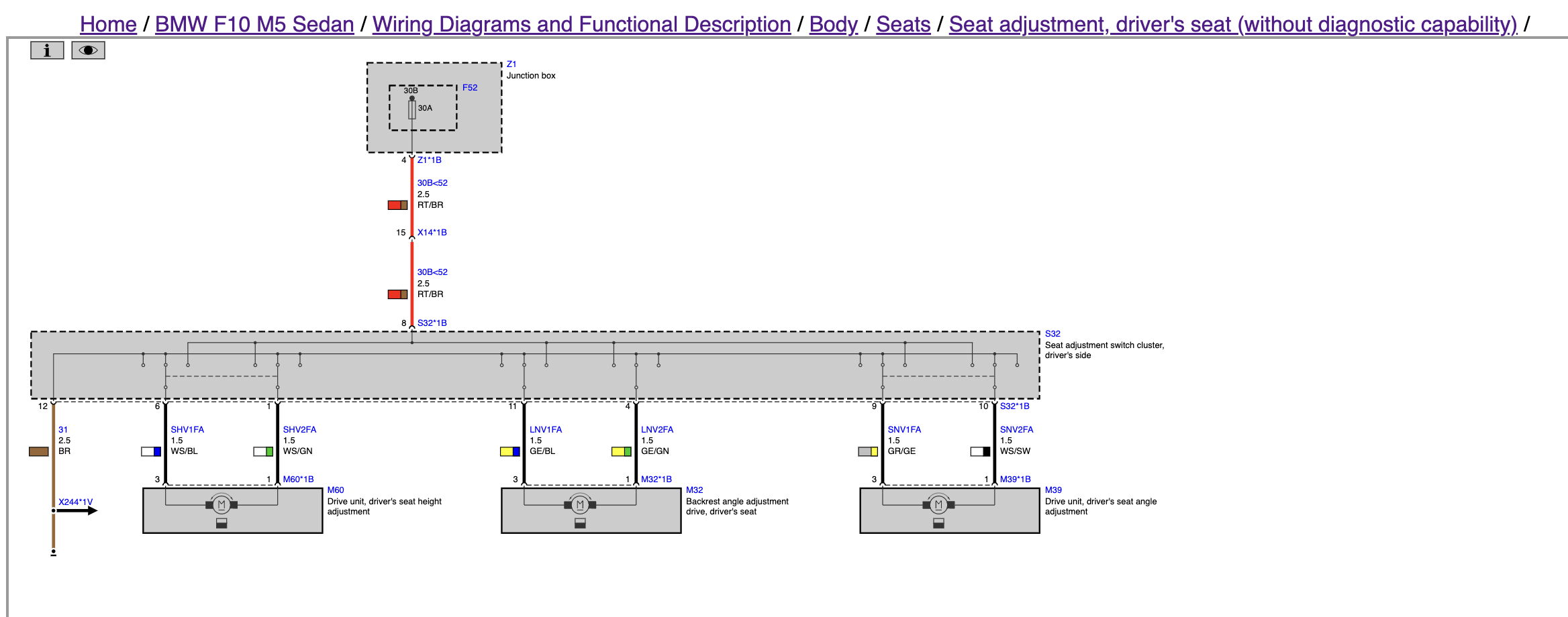

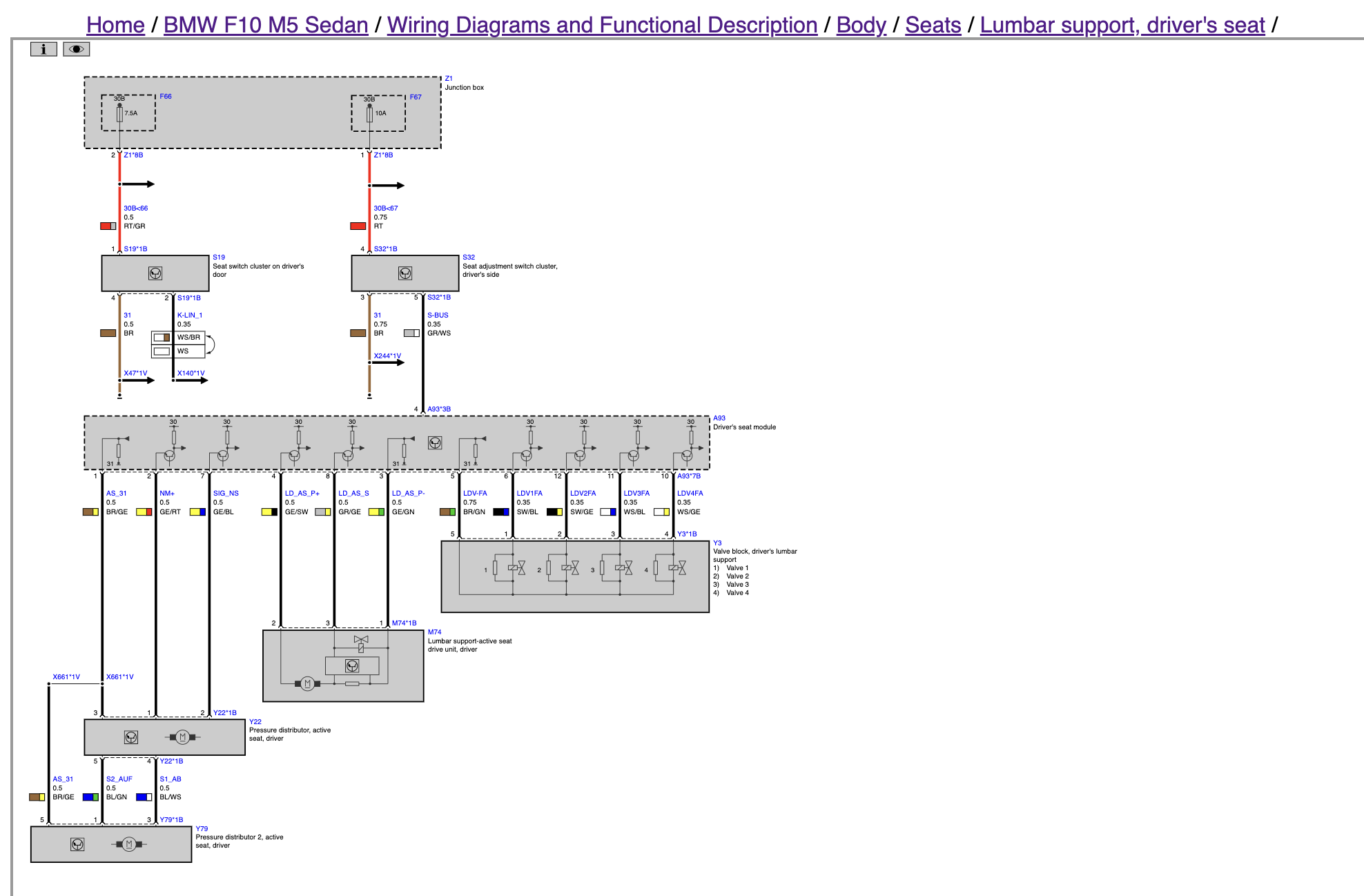

I think I realized why I can only find about 6 of the wires in all the diagrams above and guesses on 2 more (big power wires).
I need to look into the SRS and Seat Occupancy diagrams as well. Heating/vent fans, movement, lumbar and active seating appear to be covered in the screenshots in this thread.
I believe the other functions are different systems beyond "seats". So back to the diagrams I go!
Update on what I found:
For E70, 14 wires total between two connectors. "Main connector" is comprised of three sub connectors, (black and two grey), encased in a Yellow connector. The second connector is yellow with just two wires.
MAIN CONNECTOR:
Black plug:
Orange/Green - I believe KCAN feed
Red/white - 7.5a 12v feed for seat adjustment switch
Brown/Black - I think this is the wire to connect to the seat adjustment switch on side of seats?
Thick Brown - 12 power?
Thick Red/Brown -12v power?
Grey plug #1:
Blue/white
Brown/black
Blue/Black
Blue/red(or brown?)
Grey plug #2:
Yellow - appears to be seat heating
Brown - appears to be seat heating
SECONDARY CONNECTOR:
Just two wires, yellow connector, likely SRS?
Blue/Black
Blue/Brown
Sucks that there are two wires that are brown/black and two that are Blue/black!
I will keep updating. It appears the F10 M5 connector shares the colors above on the ones I have identified so far. It does have one less wire overall, despite having more "functions" it can do.

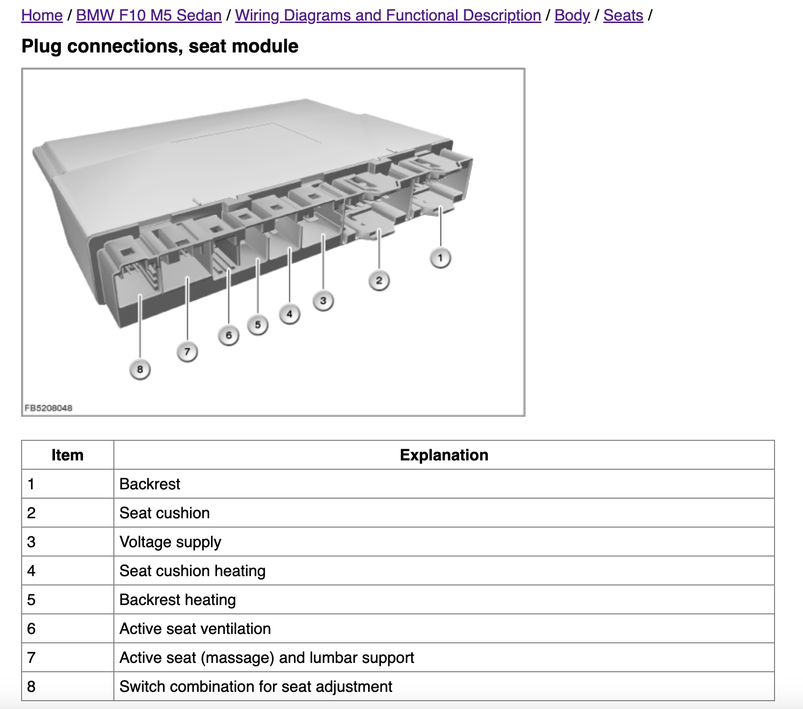

Progress! Attached is a pin-out diagram I found in this thread:
https://www.xbimmers.com/forums/showthread.php?t=542284
The question I have - how do I get to this in ISTA +? I can get to the diagrams above, but it would be really helpful to get the breakdown like the attached .pdf which was a screenshot from ISTA +
I'm still learning how to navigate through ISTA, so the help is much appreciated!
I will update this thread when done, but for now, here are those attachments showing the connector breakdown:
