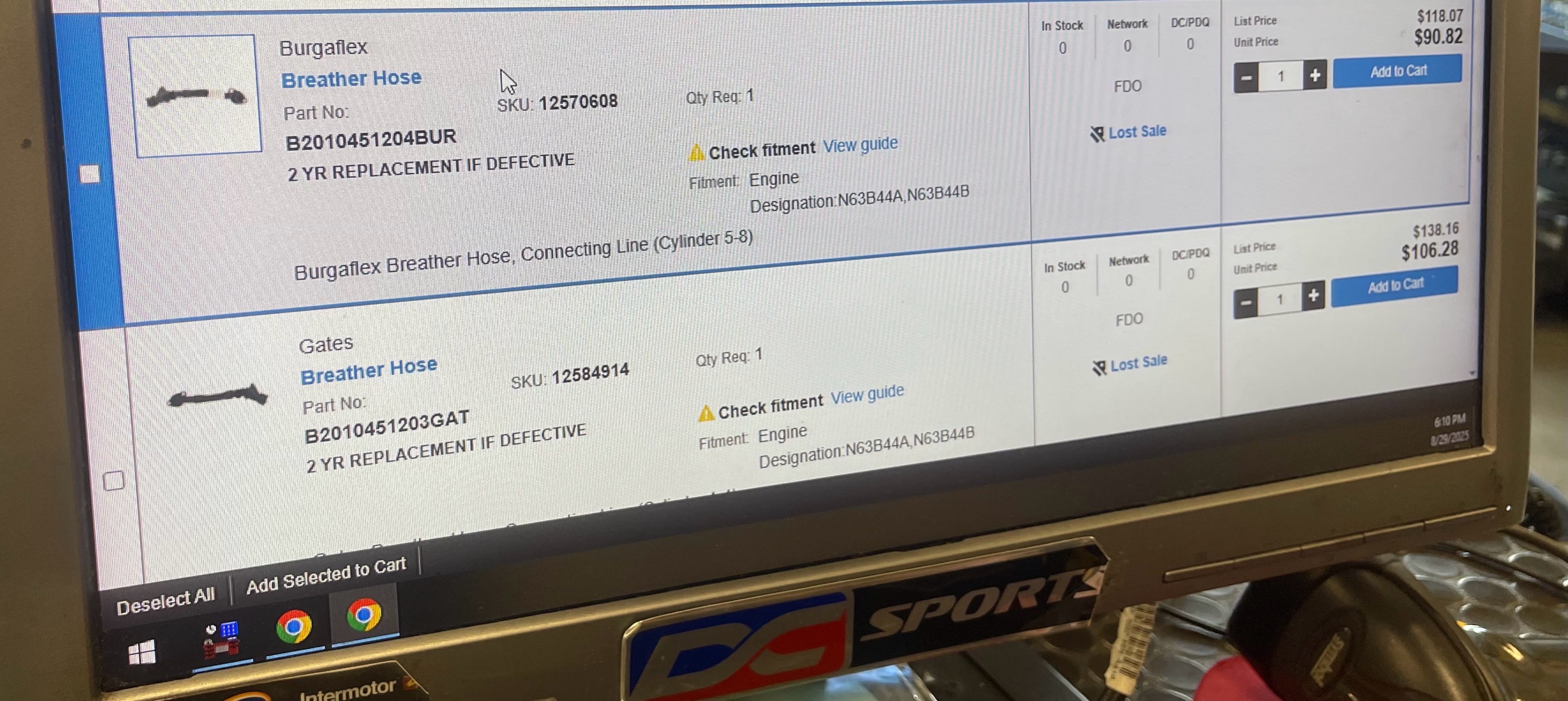

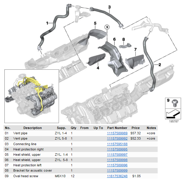

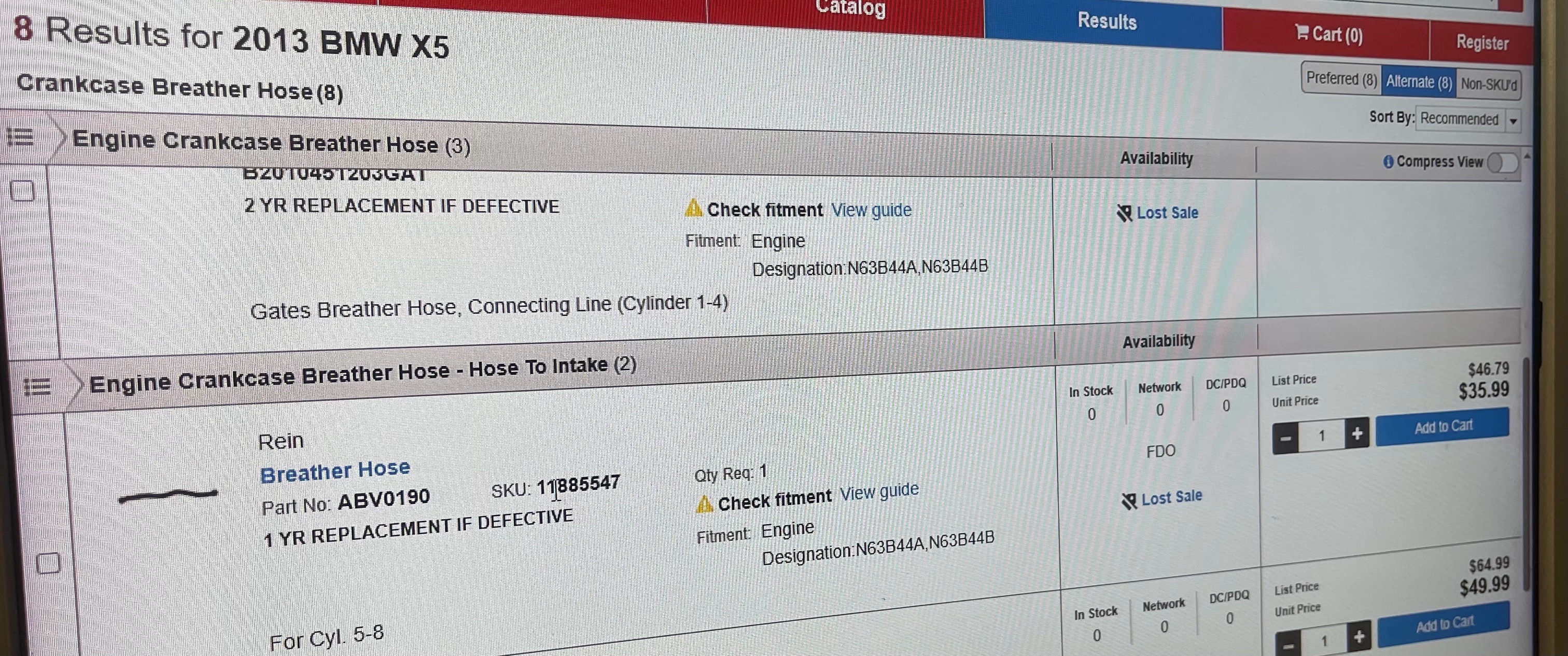

I went back today to see if I could get it fixed and he told me that the breather hoses need to be replaced. I should’ve had him send me a picture of the diagram that he would. He was showing me, but I didn’t again my fault. I understand the pictures he did show me there’s two hoses apparently that need to be replaced. The one hose was stated for $155 and the second hose was $375. Labor was another 350

You need to replace all of the PCV crankcase breather hoses. ONLY BUY BMW OEM:
a) Two Filtered Air Ducts(Bank1 and Bank2) (Part #13717589651, 13717589652)
b) One crossover hose (Part #11157595188)
c) Need two vent pipes(diagram, Part 1 and 2)(Part #11157589989, 11157589992)

Thank you for your reply. It is greatly appreciated. If you don’t mind taking a look at a few of these pictures I’m gonna post and confirm or deny those are the pieces that I need I would owe you my life seriously I went to two different Auto places to try to figure out which pieces they are in the first place had no idea and the second placeI just seemed to irritate him because it didn’t seem like he knew too much either on this vehicle so if you could take a look like I said, I would greatly appreciate it. Thank you again for replying. It means the world.
Again, I was told it was numbers six and seven on that diagram that need to be replaced. I can attach what the mechanic sent me which is just what I need if that helps you as well also and do you feel as if $350 to replace those parts a lot if you don’t mind me asking?
The two hoses priced by him were
Hose one was $155
Hose two was $375
Again, I feel like I can find them cheaper elsewhere like FCP OR ECS tuning Or how Google for that matter but again, I’d appreciate it if you could help me out

Find a mechanic who has experience on BMW.... even if you have to drive 50-100 miles away. Buy those 5 hoses I listed(Part numbers all there!) and get them installed. You can save hundreds in labor, by DIY. It's not hard - just takes time... no special BMW ISTA computer necessary.

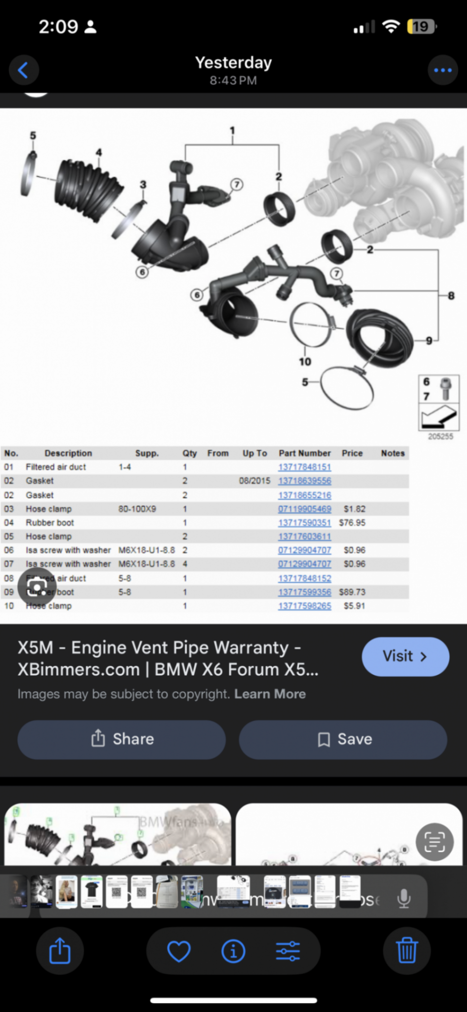

yep, FCP has them , and dont forget, FCP has lifetime warranty on the parts
https://www.fcpeuro.com/products/bmw...mw-13717848151
theres one of them. search the other part numbers and free shipping over $50

heres the other side. expensive cause theres a bunch of check valves in that tree

Sorry to reply so late. I greatly appreciate all of the info u had given me. The part number for the last intake duct u sent me is a different one than was listed. I attached a screenshot for reference. It looks the same as mine. I just want to make sure before I buy. Did they just update the part number?
Also I said that theres a lot of check valves, is there anything I should look out for if I replace myself? It seems easy enough but I’m not a mechanic, clearly lol.
Is there anything else u would recommend to change out? Besides those 5 parts? Again I greatly appreciate ur help. U guys r awesome n have another question about my stereo if u dont mind giving me some insight
