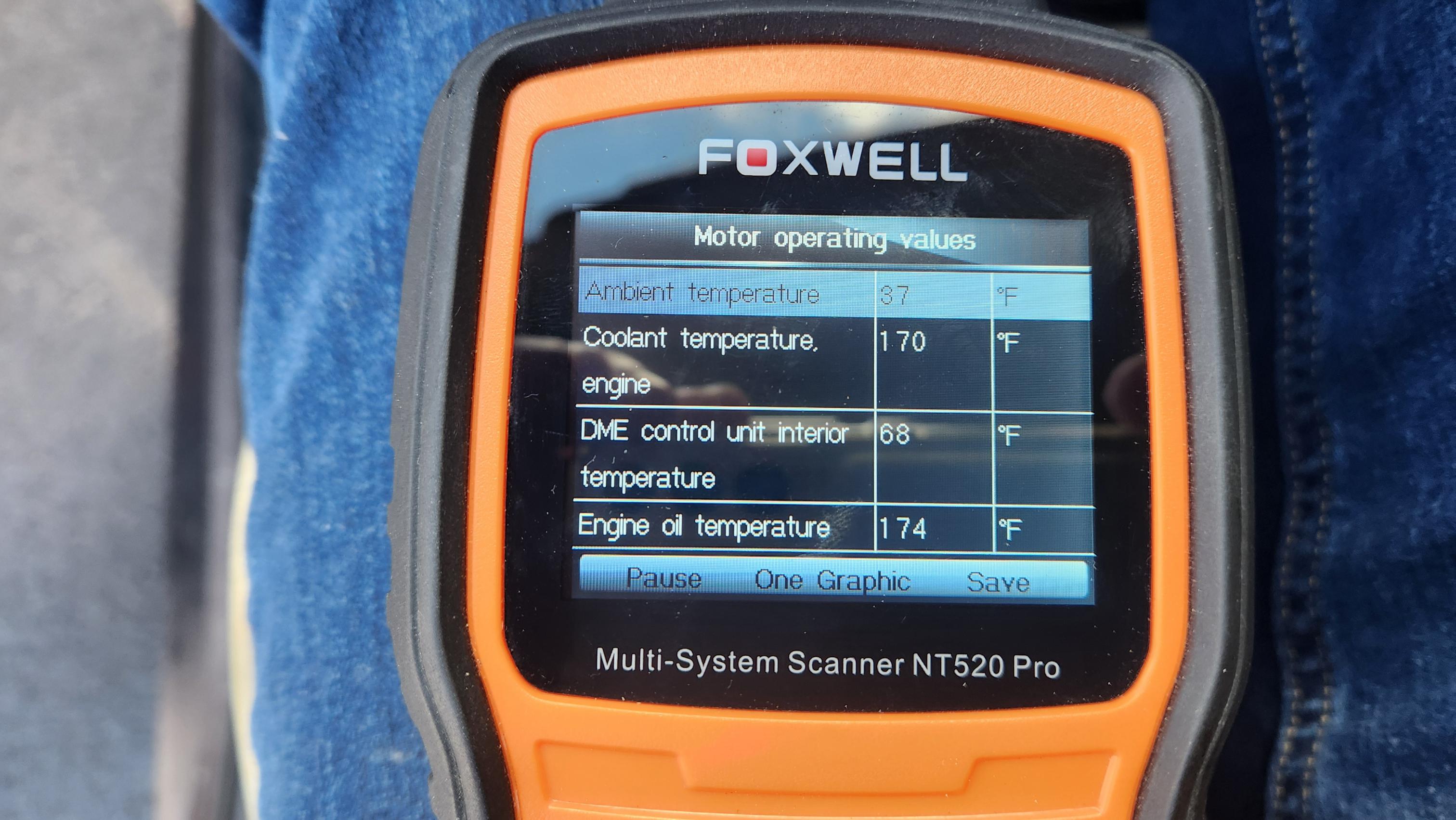

2013 x5 e70 200k miles. Cooling fan going on and off around every 30 seconds or so. I have a Foxwell scanner and it shows the operating temperatures are low. An active test of the fan shows I could turn it on and off. Coolant level is good. Any ideas?

The scanner shows the engine coolant temperature at 170degF. Similar to the engine oil temperature. The fan first turned on when the coolant temperature reached 117° f. So I don't think it's the temperature sensor. Unless the control unit uses a different temp sensor? I don't think it's the water pump either because of the same reason. The temperatures are fine. The coolant pump did fail at 70,000 miles and was replaced. Could this be due to the A/C? I did have the air conditioner compressor replaced two summers ago. It was not working and it threw an a/c clutch code.

You guys are correct. It just lit up some water pump codes and put the engine in limp mode.
Water pump was replaced at 70,000 miles ($1400) at a dealer. I did get $1,000 back from BMW from a class action suit. And now it's failed again. Not a DIY for me. One Indie quoted me $2,000 or $1100 if I supply my own parts. Seems pricey for 3 to 4 hours of labor. Also these guys aren't available for a month. I think some expert BMW mechanics in my area have been detained and deported.
FOXWELL Fault Codes
3792/not present
Engine cooling system
Coolant pump speed outside of tolerance
