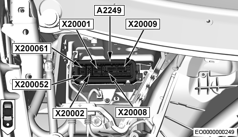

Figured I'd update my findings for anyone else interested, removed my upper intake manifold to get access to the low pressure fuel line that also has a temp/pressure sensor, removed the connecter and found diesel in there, so need a new low pressure line.
Opened the DDE which was a pain, sprayed it with contact cleaner to get rid of the excess diesel, didn't see any physical damage on traces or any components so I'm hoping the DDE is still good.
Waiting on a low pressure line but I'm confident the diesel in the connecter or DDE was causing an intermittent short.
I found electrical information as well, the only thing touching diesel fuel on x20008 is the fuel temp/pressure sensor.

Pictures of the DDE once opened, there is a thin film of diesel on everything, hard to see in the pic.
